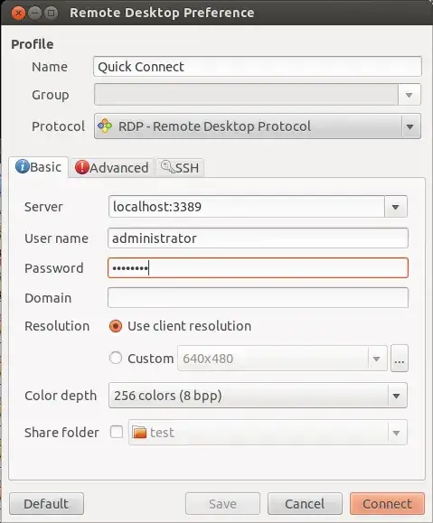

  5. Run a remote desktop viewer (e.g. Remmina which is installed by default).
    • Connect to localhost:3389 (or another port if defined differently in 2.)
    • Use the name and password of the account from which Virtual Box is running. enter image description here
    • Adjust display geometry or color settings according to your needs.
