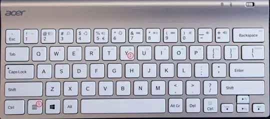

It seems your tablet Acer Iconia W700 maps the Function key into some weird combination for making the keyboard a little smaller (found here). I don't have the device, but from the review I've known that, Alt-F4 is mapped to Alt-Fn-R key. So, I think the F6 is mapped to something like Fn-Y key (later verified it from the screenshot here). So, press that key combination to bring the context menu for boot parameter passing.
Check the screenshot below to see the combination
acer icon w700 f6 key combination

Image courtesy: The review linked with the answer.
