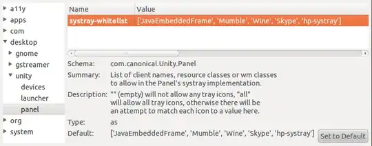

Until they get perl bindings for app indicator, you can whitelist Shutter systray as per the one-line command posted in this question,
gsettings set com.canonical.Unity.Panel systray-whitelist "$(gsettings get com.canonical.Unity.Panel systray-whitelist | sed -e "s/]$/, 'shutter']/")"
GUI Editor method
  1. Install dconf-toolsInstall dconf-tools
  2. Open dconf-editor
    Run Command Alt+F2 and type dconf-editor
  3. Navigate to desktop => unity => panel
  4. Add the text ,'shutter' to the end of the list (inside the square bracket).
  5. Close dconf-editor and restart Unity (Run Command Alt+F2 and type unity)

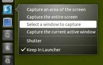

Shutter doesn't have an indicator because there are no indicator bindings for Perl.
Instead I keep shutter on my launcher and just use the quicklists to do take fast screenshots:
