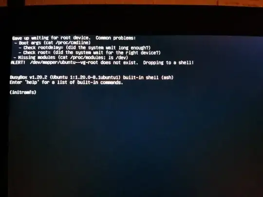

it does not reliably boot. i often have to try several times, those are the errors i get:
... alert! /dev/mapper/ubuntu-vg-root does not exist ...

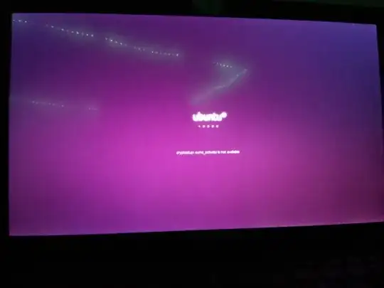

enter image description here and sometimes it "boots" without asking me for the password and then fails with cryptsetup: cvms_activate is not available
