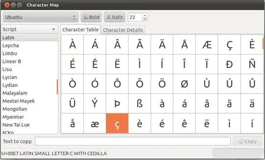

Using the Character Map you can copy and paste the character.
Character Map: Ced
