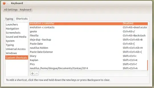

There is a simple workaround for what you need.
  1. First you will have to install xdotool Install xdotool.
  2. Then launch the Keyboard configuration gnome-control-center keyboard:
    (Go to Shortcuts → Custom shortcuts)
  3. Click on "+" and add a name like "Paste into terminal" and the command
    xdotool key --clearmodifiers ctrl+shift+v
  4. Then choose Shift+Insert as the key binding:
Because of a bug, you will have to logout and log back in so the shortcut can take effect.

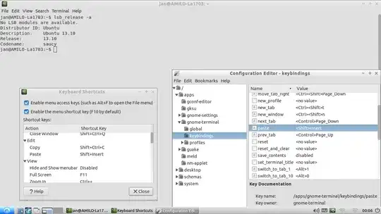

If you don't want to use SHIFT+CTRL+V, then why not just change that paste hotkey to SHIFT+INSERT under Edit > Keyboard shortcuts?
I installed gnome-terminal on lubuntu 13.10 and I have that option (see screenshot I already changed it there). If you don't have it you might try to change that setting in gconf-editor, see the screenshot.
