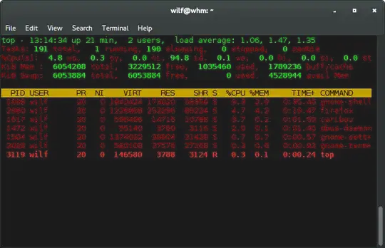

A generally helpful thing to find which processes are hogging the CPU is top: top screenshot then you can press k and type in the PID of the process, and then press Enter twice to kill it;

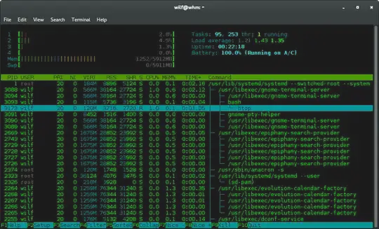

Another program that can do this is htop: htop screenshot This can also system resources being used, and processes can be killed by selecting them, pressing k, and then pressing Enter. Parent processes can also be found by pressing t to toggle tree view.
