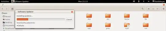

I will show it through the following image:
This shows that I am still stuck up in a file manager similar to Unity, and features like minimise are missing.
I wish to know how to get GNOME into proper shape. Will I be able to install apps like GNOME maps, Musics, ect...
You're problem is that you are using Unity's theme. Gnome uses Adiwaita by default. To change your theme, follow these instructions:

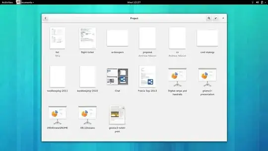

Gnome maps and music are part of Gnome 3.10 wich is not incluided in the latest stable ubuntu release (13.10) and gnome-shell also features 'no minimize' buttons since developers didn's see the need of it(I have no idea if you can re-enable the buttons) an even some applications like files(renamed nautilus) and other gnome core applications no longer have a window bar with close button but have this button bundled in the toolbar as you can see:
http://www.gnome.org/gnome-3/
