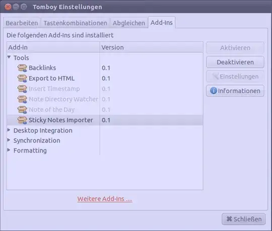

enter image description hereThis should be done automatically. If you take a look at Preferences->Add-Ins there is the Sticky Notes Importer under Tools. This should be active.
