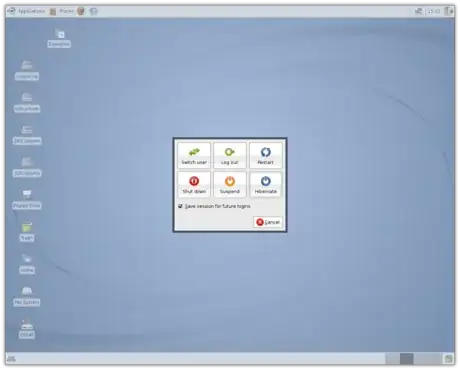

I installed Xubuntu and used one of shutdown functions when shutdown it.
It looks as follow image:
logout
I leaved tick and now I always login at this session.
But I want to leave this session and login as typical.
  • How to discard this session, and login without saved session?

Xubuntu stores your session information in ~/.cache/sessions. If you want to start with a clean slate, you need to remove the information present in that folder.
To do so:
  • Log out of Xubuntu.
  • While at the login screen, press Ctrl+Alt+F1 to open a console. (You may need to press Enter once to get the login prompt.) Enter your usual username and password.
  • Create a temporary folder, Backup, on your Desktop. Return to your home folder. From there, issue the following command to recursively copy the contents of ~/.cache/sessions to your desktop (as a safety measure):
    • mkdir ~/Desktop/Backup
    • cp -r ~/.cache/sessions/* ~/Desktop/Backup
  • Delete the contents of the sessions subfolder:
    • rm -rf ~/.cache/sessions/*
  • Close the console by pressing Ctrl+Alt+F7
  • You'll see the usual login screen again. Now, when you login, you'll have a clean slate.
Note that there is a GUI method available but some people find it doesn't work as reliably as the console route.
You should erase old sessions and make session folder read-only: $ rm .cache/session/* $ chmod -w .cache/session
See my full answer here: https://askubuntu.com/a/469808/27057
