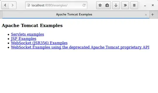

The correct way
After installing the package tomcat7-examples restart your tomcat7
sudo service tomcat7 restart
After that open the URL http://localhost:8080/examples/ and you will see this
