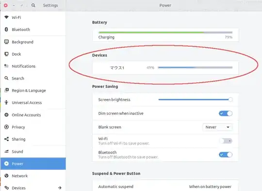

On Ubuntu 17.10 or above, there is a magic mouse battery indicator in Settings > Power > Devices.
