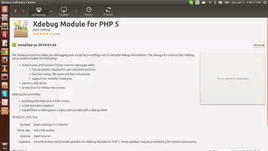

I do not know it is an answer or not.but after so much debugging and suggestion by @Braiam i found that my xampp is 32bit, so i installed 64 bit xampp on my 64 bit ubuntu 13.10. which solve my all problems related to xdebug installation on ubuntu os. ( i installed xdebug from ubuntu software center. ) enter image description here
