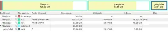

Gparted screenshot
My hypothesis is that the problem is in the hard disk, so I came to the questions:
  1. How can I verify my hypothesis? Is it plausible?
  2. Since Windows in in sda2, Ubuntu in sda5 and sda3 contains only data do you think it is a good idea to move Ubuntu to the left (resizing sda3) and then leaving the last part of the disk (where probably there is the problem) empty (in a new partition)?
