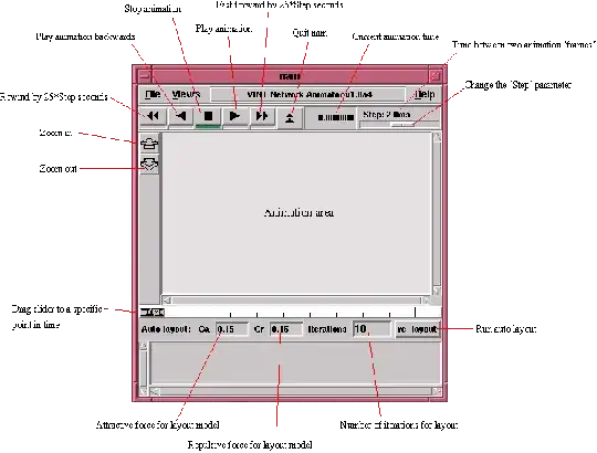

I finally could solve my problem haha!!!
the problem was the nam package, It must be installed to show the GUI, I installed it by:
apt-get install nam
After this installation every thing will be okay
screenshot: enter image description here
