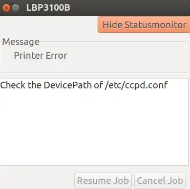

Regarding this "Answer", I've installed the canon CAPT driver on my machine, but when I try to start/restart ccpd, I get this error:
chec the DevicePath of /etc/ccpd.conf
However, the printer doesn't work unless I start ccpd. Here is the content of /etc/ccpd.conf:

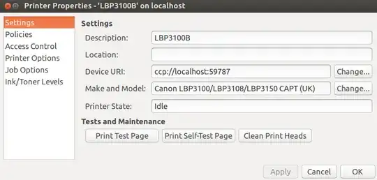

The below picture is captured from the printer properties dialogue:
LBP3100B on localhost
