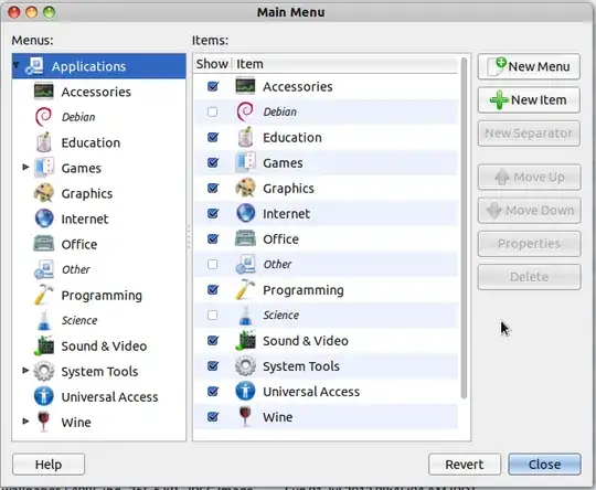

You can easily change any installed program in your Ubuntu using "Main Menu" (package name is "alacarte"). You can download it from Software Center by typing "Main Menu" and then:
  1. Run "Main Menu" program.
  2. From right panel called "Menus" find your program (in this case it is in "Wine" node) and select it in "Items" panel.
  3. Click on properties button.
  4. From showed dialogue select icon button that located on top left.
  5. Finally browse the location of your new icon in your file system.
After doing above steps you will see your new icon in Unity launcher and panel.

Use Alacarte (the old menu editor, you might need to install it) to create an old style menu entry with an icon and a executable that launches your program. Than search for this via alt + F2 and pin it to the launcher.
