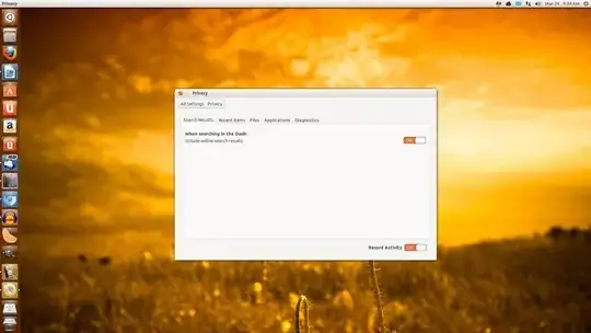

You should be able to turn off Online Scopes in the Privacy Settings. enter image description here
There is a list of the available scopes/lenses here, you should be able to remove them in software centre, or with sudo apt-get remove....
