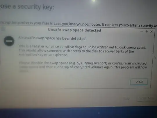

So I had a Ubuntu 13.04 installation and I had encrypted my hard drive while I was doing installation. I was playing around and mistakenly deleted all the partitions, now I downloaded lUbuntu 13.10 x86 Desktop but when I am trying to install it says "Unsafe swap space detected"
I am clueless on how to fix this error.

Try to boot via "Try Ubuntu" instead of "Install Ubuntu" and run the command:
sudo swapoff --all
From the terminal. (ctrl+alt+t)
Then run the Install Ubuntu from the desktop. The error should stop appearing.

Len's solution of running sudo swapoff -all is possible without booting via "Try Ubuntu".
When you get the error, use CTRL-ALT-F1 to get to a terminal and run the command there.
Use CTRL-ALT-F7 to return to the graphical environment when you're done.
It worked for me. I did so after going back to the language selection screen, but it may work from the partition manager stage. I would expect the check is only being done at the moment one attempts to change a partition.
