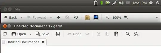

My Faenza-Alan looks like this: Faenza-Alan's app-indicators and back/forward and the paste icon in gedit
In testing this, I see that it's probably a bug that Faenza uses a light app-indicator icon for any of the dark themes. Anyone know where you can file a bug?
