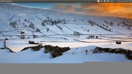

I used gsettings set org.gnome.desktop.background picture-uri 'file://PathToImage' to set an image as a wallpaper as suggested in this answer. This does not do the job properly. For today's bing image, script here changes my background like this
Image of my desktop
This happens at random and sometimes it sets the wallpaper properly. Using GUI, setting the image as wallpaper by right-clicking on it works properly every time. Any possible causes of this problem?
Edit1: The download is perfectly fine. As I have mentioned, I can set the photo as wallpaper by right clicking the photo and chosing 'set as wallpaper' from the menu.

You mentioned
As you can manually set the wallpaper the problem may be on the cache, which is generated before the downloader completely write the data on the file. So regenerating the cache in this kind of case is necessary.
So delete wallpaper cache rm /home/$USER/.cache/wallpaper/* . Add this code to end of the script after some sleep.

The following command is correct and should work in any circumstance:
So, I assume that the main reason why this thing is happen is because, as @d3vid noted in his comment: the download is failing (only downloading a partial file) or the background is being displayed before the download is complete.
To solve your problem be sure that you have a better internet connection when you run the script from your question or try to use curl instead of wget as in the script from my answer here.

Maybe in the script, you should first download the new picture in a temporary file like:
wget --no-proxy --output-document=dwallpaper.temp (...)
And only after the wget command is done, do:
cp dwallpaper.temp dwallpaper
This way, gsettings is always pointing to a file 100% downloaded which may fix the issue you observed.
