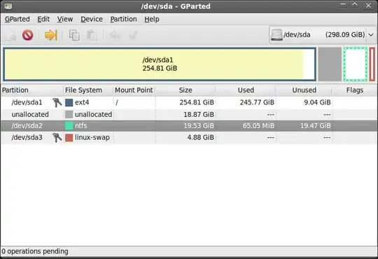

You can use GParted to format partitions.
Unmount all the partitions on the USB stick, and then delete them. You can then create partitions as you like - creating a new partition table first (under Device) may also help. The is some documentation here if you need any.
This should effectively wipe any partitions and any data in them. - remember to click this green button, or it won't do anything smiley:
Be sure what you are formatting - the computer's primary hard drive is usually sda, and may contain important things (e.g. dual booted windows)
