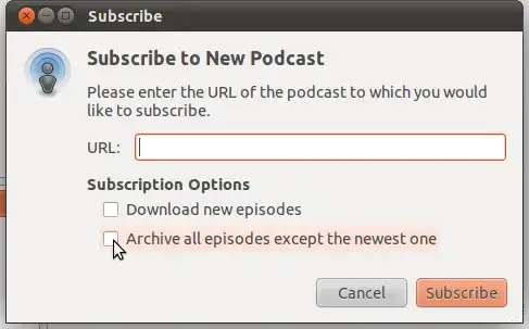

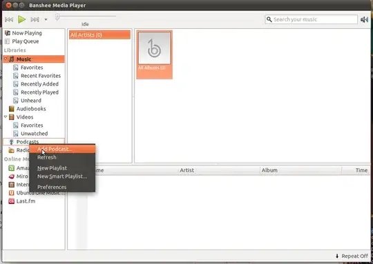

I am not sure how to get the old podcasts out, but adding the podcasts and re-syncing can be done as shown below:
