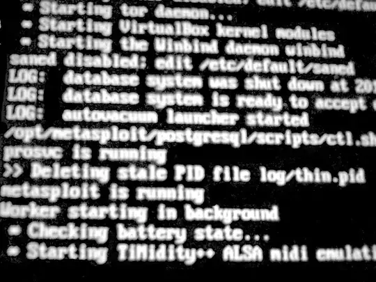

I have only Ubuntu 12.04 on my system. After I installed some updates, I restarted and the boot sequence would skip the GRUB Menu and go straight to the first option (normal Ubuntu boot).
Even if I press Shift or Space, it would not load. It would start to load the Ubuntu logo, then go black.
If I press Ctrl+Alt+F1 then I am able to login, and run some commands, but if I go to the graphical mode (Ctrl+alt+F7) then it is stuck in the picture shown here.
I want to boot via the recovery mode.
http://tinypic.com/r/33eiyd3/5
I haven't tried boot-recovery, but I will. Anything else I can do?
update #1: I removed timidity, and restarted (in hindsight, timidity wasn't the problem as it was the last thing that had [OK] next to it). Now it boots, but it goes into a black screen after it displays the Ubuntu logo, right before it is supposed to go into desktop. It's not a black-screen-no-signal thing, it is like the background is all black. I tried booting from USB, and the same thing happened. I am slightly annoyed, because there is no apparent reason for this. Now I can't even go into the terminal. I would be happy to receive any suggestions.
