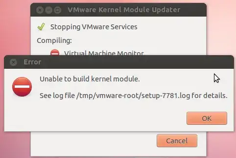

when I try to install VMWare Player on Ubuntu 12.04 LTS I get the following error:
Unable to build kernel module.

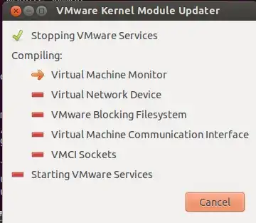

EDIT 1
The screen-shots bellow show what I see after I complete the installation

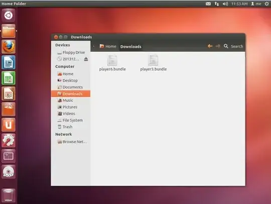

Step #1: Navigate to the directory you've saved VMware Player in.

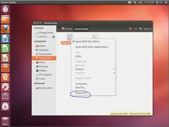

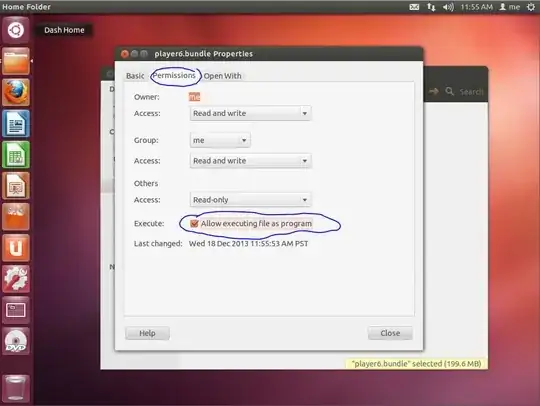

Step #2: Right click on the .bundle file and open the properties menu.
Step #3: In the permissions tab check the box for "allow executing file as program".

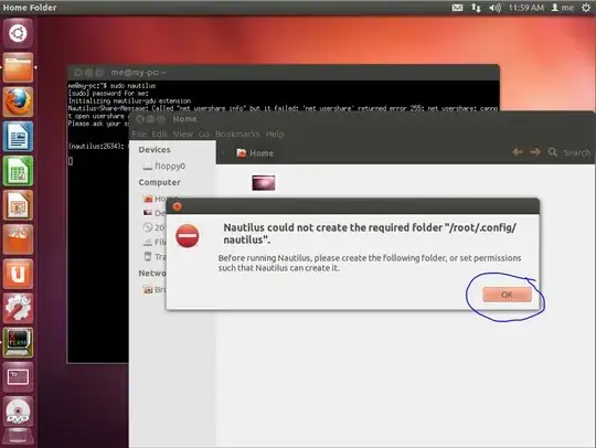

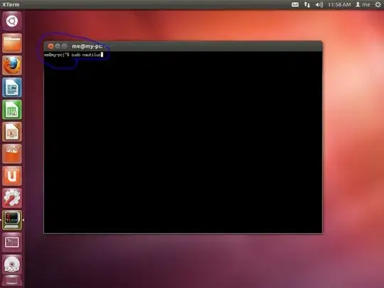

Step #4: Open terminal and type "sudo nautilus" as root privileges are needed.
Step #5: Click "ok" on the error message regarding nautilus. img5

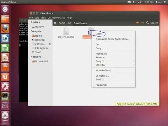

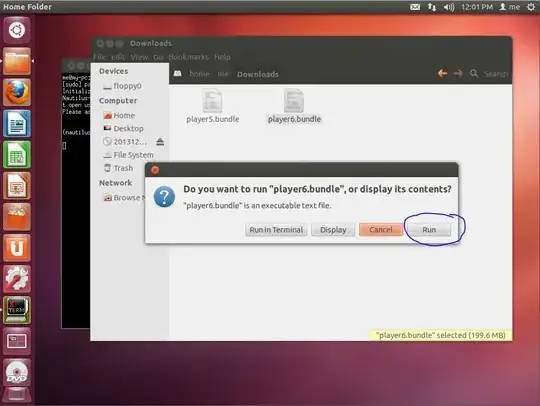

Step #6: Navigate to the directory you saved the .bundle file in, right click, and choose "open" from the menu.
Step #7: Choose "run" as it will allow for graphical installation.

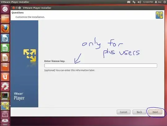

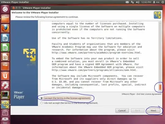

Step #8: Accept the Vmware Player End User License Agreement and click "next".

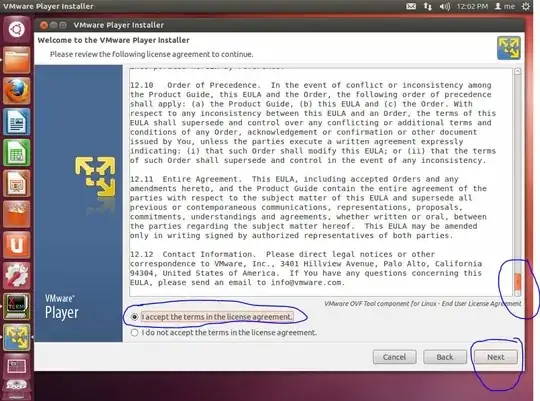

Step #9: Accept the VMware OVF Tool Component For Linux License Agreement and click "next".
Step #10: Choose appropriate update option to your liking and click "next".

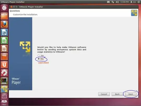

Step #11: Choose appropriate statistics option to your liking and click "next".
Step #12: If you have a plus key you can enter it now, if not don't worry about it, and click "next".

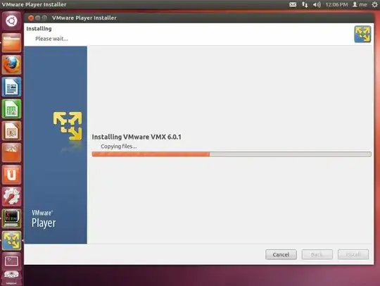

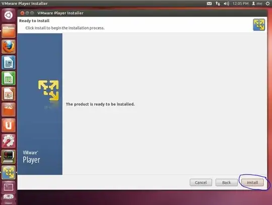

Step #13: Click "install".
Step #14: The installation will begin, please wait for it to finish.

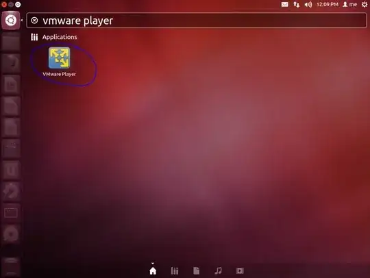

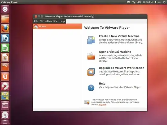

Step #16: Search for "vmware player" in your unity search area. Click on "Vmware player".
Step #17: VMware player will open and be ready for use. [You may need to run vmware player as root to download the vmware tools.]
