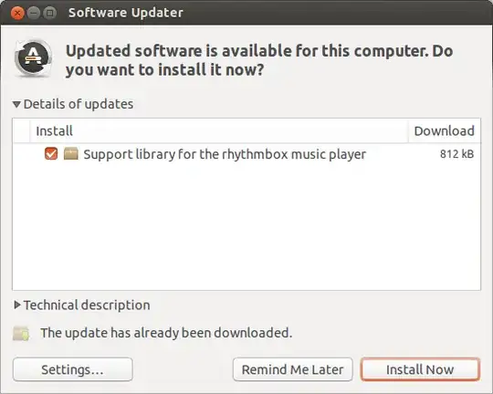

I am having trouble updating with Rhythmbox. I'm using ubuntu 13.10
I have purged it and did a new install and I keep getting an error message:
Imgur
When I attempt an upgrade:
