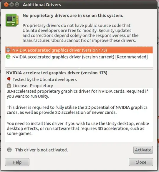

Did you install the nvidia drivers in the additional drivers?
It should prompt you to install them, in the panel you should see a little icon.
If it doesn't they can be found SystemAdministrationAdditional Drivers, then go ahead and activate the appropriate driver (probably the current version).
After that you will need to restart your computer when prompted and Unity should work.
