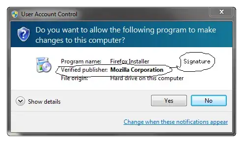

Windows has a signature system which allows you to make sure that an executable hasn't been modified after it has been signed. I used to use this as a security measure in Windows. enter image description here enter image description here
Does linux have such a system which allows developers to put signatures in executables and .debs so that the user can verify them? So, for example some one gives me a modified version of a program. I can see if the programs signature is valid or if it has a signature in the first place.
