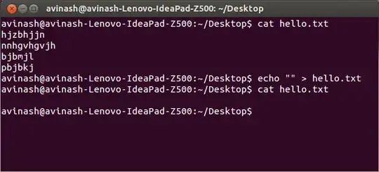

If a file was created with the name hello.txt and was provided with some texts then the below command in terminalctrl+alt+t will remove all the text in the hello.txt file,
echo "" > hello.txt
