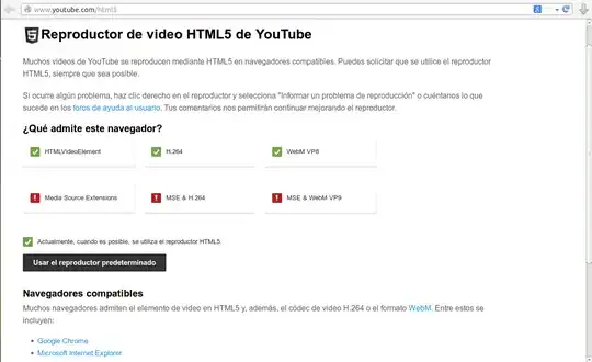

I used this test site and the YouTube HTML5 page to verify that h.264 support works in Google Chrome on my Ubuntu 12.04 64-bit, but does not work on Firefox 26.

Just visited the HTML5 Youtube test and I have H.264 checked; you probably will need to install Ubuntu restricted extras to get the gstreamer codecs.

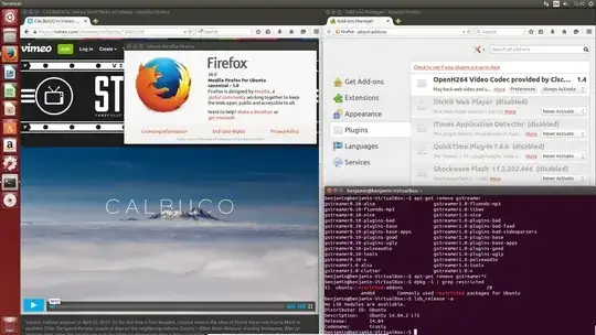

14.04.2 with restricted addons
As you can see in this screenshot only the OpenH264 plugin is enabled in Firefox, all the necessary GStreamer packages in different versions are preinstalled and the video plays as expected.

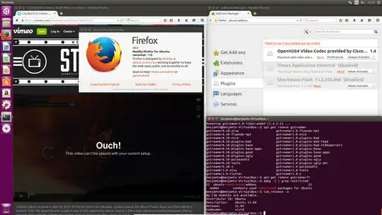

15.04 without restricted addons

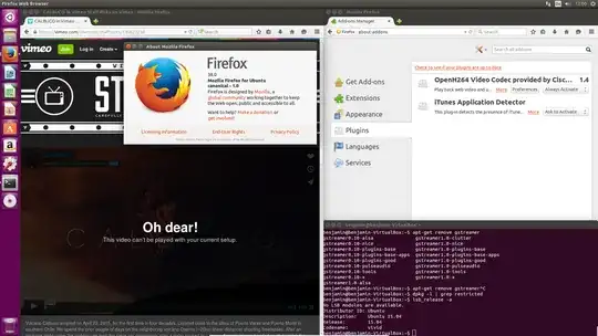

As you can see in this screenshot the OpenH264 plugin is enabled, there is no Flash plugin, a few GStreamer packages in different versions are preinstalled but the video does not play! Instead the site immediately tells us that the video can't be played. Why is that?

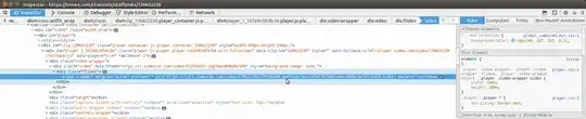

  • AAC is missing! – To put an explanation simple, there is a file on the server that is fed into our browser. If you look for it using the inspector from the context menu in Firefox, you will find an MP4 with AAC-encoded audio. The error message could be more clear but it makes sense since we don't have a decoder for AAC currently installed.

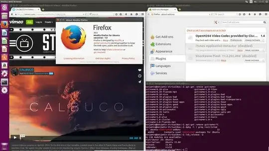

15.04 with restricted addons
A smart approach would have been to install gstreamer1.0-plugins-bad-faad, but this doesn't make the particular error message on Vimeo go way, so let's install all the restricted addons.
As expected, everything works if you install the restricted addons package afterwards, but you may want to set the Flash plugin to something else than enabled in Firefox to be sure to use HTML5 video.

Apparently gstreamer1.0-libav is the only package you need to remove to get the error message back. So it was using libav's AAC decoder? I didn't dig deeper to find proof for that nor did I look for which decoder will be preferred (e.g. if OpenH264 is of any use currently on Linux) or if Vimeo throws this error message due to some other dependency not being met despite H.264 and AAC decoders being installed.
