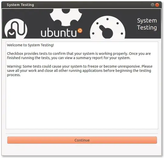

Try
System Testing
System Testing, can test your system and submit results to the Ubuntu Friendly project.
You have to manually participate for the test.
To install, just click System Testing Install comixcursors-lefthanded
Can also install with :
sudo apt-get install checkbox-gui

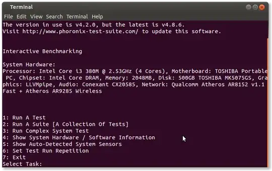

Phoronix Test suite
You can use Phoronix Test suite. It is best testing Utility for Linux Systems.
It is having a Dash icon. But runs in terminal. Takes few hours to run a comprehensive test. Finally gives a report.
Install via the software center
Or:
sudo apt install phoronix-test-suite
