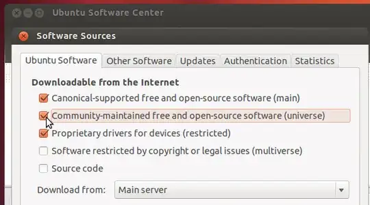

First open the Ubuntu Software Center, in the Edit menu click Software Sources..., and in the window that appears enable universe as seen below:
Then run sudo apt-get update.
You should now be able to install chntpw using sudo apt-get install chntpw.
Do this from the terminal
sudo add-apt-repository universe
sudo apt-get update
