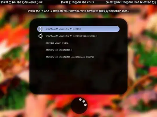

Grub does have some theming capabilities - we already have a great Q&A that covers how to change the Grub background and changing the text menu colours:
However, to answer your very specific question, it is not possible to convert the text selection in Grub2 to Iconised symbols. This is one of the reasons why BURG was created.
UbuntuForums has a great thread to cover Grub2 themes and more importantly screenshots showing the themes that can be achieved.
(post #61)
This screenshot was created by:
  1. adding a background image
  2. installing a grub-font
  3. installing grub-icons for each OS (called a class)
I'm loathed to duplicate such a great tutorial here as per the first post in the thread. Its pretty much self-explanatory on the steps you need to do.
