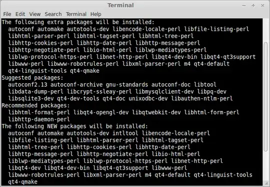

Well, I think maybe you ran something a bit more malicious than what your posting in your question. Here's a screen shot of what apt wants do when I run sudo apt-get install libqt4-dev intltool
It isn't removing any package already on the system. These both appear to be development tools; one for XML and the other for qt.
Maybe, when you copy and pasted from the internet you got more than you expected.
