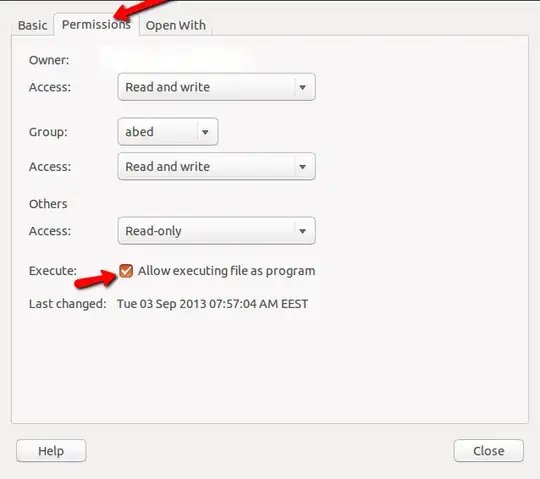

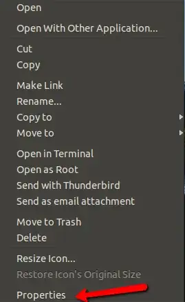

Right click on the file, choose properties, and once the new windows opens, go to the Permissions tab, and make sure that you have a check mark on Allow executing file as a program. See images below.
Or you can use Radu Rădeanu answer to do it from terminal.
