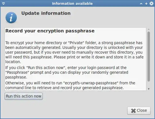

You can do that by running this command at terminal:
ecryptfs-unwrap-passphrase ~/.ecryptfs/wrapped-passphrase
The information you missed when you skiped was:
