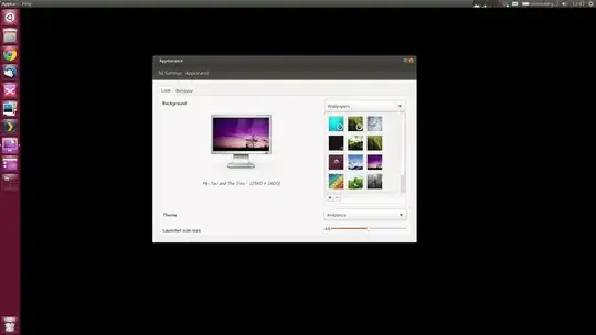

I am running 13.10 and installed GNOME 3.10 with the gnome3-next ppa from Team GNOME, as explained in an article on Webupd8.
How can I get back to Unity?
I did a ppa purge and now sort of have Unity back, but still have the GNOME boot screen, the font, the close button for windows on the right side. Also if I minimize an application, Xorg and the application have around 100% CPU usage.
Screenshot
I also tried sudo apt-get install unity and sudo apt-get dist-upgrade, but it's already up to date.
I have my home folder backed up with Déjà Dup, but I would like to avoid reinstalling and reconfiguring my whole system.

Since you have already used ppa purge you could now:
sudo apt-get install --reinstall ubuntu-desktop
or this with an added --reinstall:
sudo apt-get install --reinstall unity unity-common unity-services unity-lens-* unity-scope-* unity-webapps-* gnome-control-center-unity hud libunity-core-6* libunity-misc4 libunity-webapps* appmenu-gtk appmenu-gtk3 appmenu-qt* overlay-scrollbar* activity-log-manager-control-center firefox-globalmenu thunderbird-globalmenu libufe-xidgetter0 xul-ext-unity xul-ext-webaccounts webaccounts-extension-common xul-ext-websites-integration nautilus nautilus-sendto nautilus-sendto-empathy nautilus-share activity-log-manager-common python-zeitgeist rhythmbox-plugin-zeitgeist zeitgeist zeitgeist-core zeitgeist-datahub
use-
sudo apt-get install ubuntu-desktop unity
then remove what you have installed before by -
sudo add-apt-repository--remove ppa:gnome3-team/gnome3-next
sudo add-apt-repository ppa:gnome3-team/gnome3-staging
sudo apt-get purge gnome-shell
sudo apt-get purge gnome-documents gnome-contacts epiphany-browser gnome-boxes gnome-shell-extensions gnome-tweak-tool bijiben gnome-clocks
sudo apt-get update
sudo apt-get upgrade
sudo reboot
hope it helped you.

solved by re-installation.
