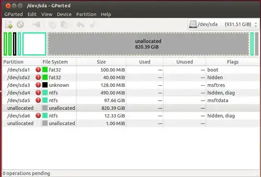

When I click yes, GParted shows my partitions, but with red errors that make me nervous:
GParted

You last entry shows that gdisk will write a protective MBR with a write. So use gdisk and write the partition table.
sudo gdisk /dev/sda
Command (? for help):
at commands use p to list partitions, if they look ok then do a write at gdisk command. If not ok use q to exit. ? will show commands. It will just rewrite the gpt data, but also automatically write a correct protective MBR entry.
The protective MBR has just one partition table entry so old partition tools like fdisk will not try to write to it without at least showing that it is gpt. You only delete all gpt data if you install Windows in BIOS mode. But your Windows is UEFI and then can only be UEFI.
