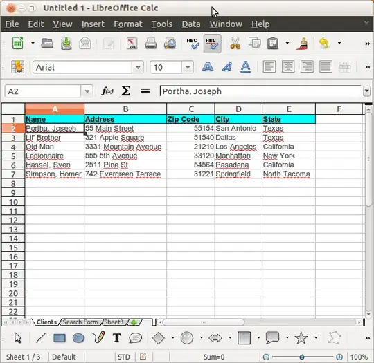

Let's say we have a spreadsheet with the details of your customers, as shown in the next small table called "Clients" (see the name at the bottom of the spreadsheet).

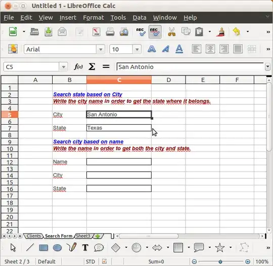

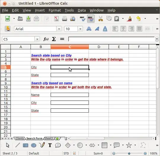

Now, let's rename "Sheet2" and use the "Search Form" name for it. After which we'll setup certain cells in order to contain the desired data as follows:
Now, having in mind that we have a "vertical list" where the data is having a column name and rows containing the details of each record, we'll use the LibreOffice's VLOOKUP function in order to search for the desired data and bring the results on the corresponding cells, as follows.
  1. In the C7 Cell of the "Search Form" spreadsheet, (which will correspond to the "State" Data), we put: the next formula:
    =VLOOKUP(C5,Clients.A2:G7,2)
  2. By Default we'll see a #N/A error message in the cell but it is caused by the NULL data in the "City" cell (C5), we'll solve this issue by writing something in the C5 Cell, something like "San Antonio" and the form will deliver the right State in the proper cell as shown in the next screenshot.

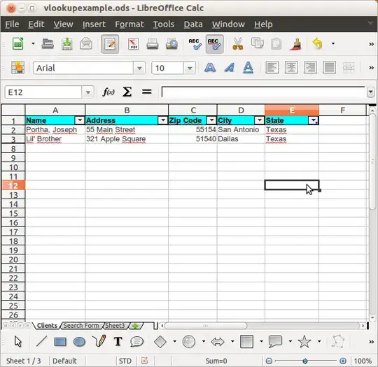

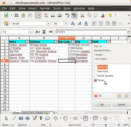

Now, if you need to run simple search solutions you may wish to use the "Filter" options in the "Data" Menu of LibreOffice. To do this simply go to the spreadsheet where the data resides, make sure it includes headers (titles for the columns) and hit the "Data" Menu, then "Filter" next "AutoFilter". Your column names will get a small button with an arrow pointing to downside. If we hit any of these small icons we'll see useful filtering data in order to separate the data in a reduced group which will contain only the desired data as seen in the next screenshots:
Auto Filter buttons
Auto Filter options for the State Column selecting only the Texas State enter image description here
Results of choosing only the Texas State in the drop down filter options. Please note that the small icon for "State" is now blue, indicating filtering on this criteria enter image description here

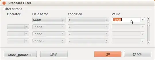

If you wish to do some additional search, you can run a "Standard Filter" from the options on any of the drop down auto filter buttons and you will see something like this:
In this dialog window you can use as many filter criteria as you need in order to keep only the desired data, remember that filter criteria values shows a drop down menu with a selection of the values in the table.
