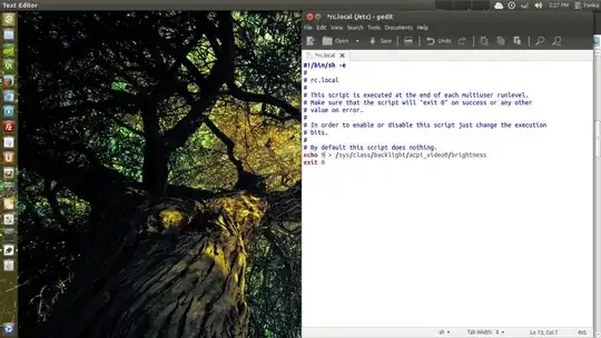

Press Ctrl+Alt+t for openeing terminal then use -
cat /sys/class/backlight/acpi_video0/max_brightness
it will give you the maximum brightness value, to change it for after booting open-
sudo gedit /etc/rc.local
and add the line shown below before exit , look at the screenshort I have attached-
echo 0 > /sys/class/backlight/acpi_video0/brightness
Change 0 to the maximum value as got from previous command output.
as shown here-here changing
Now just save it and restart. Hope it helped you.
