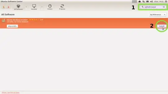

Besides that you can install it building the source, you may want to install using the Software Center, it's simpler. Search sqlitebrowser, click on install and done.
search and install sqlitebrowser on the software center
