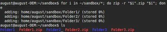

try with command I have tried in the image , hope thats gonna help you.
For removing you just can add an extra line that
rm -rf $i
The total command can be as
 for i in ~/sandbox/*; do zip -r "$i".zip "$i"; rm -rf "$i"; done
The command which deletes Folders after verifying successful Zip creation.
for i in ~/sandbox/*; do zip -r "$i".zip "$i" && rm -rf "$i"; done
Thank you @evilsoup for noticing. hope that helps.
