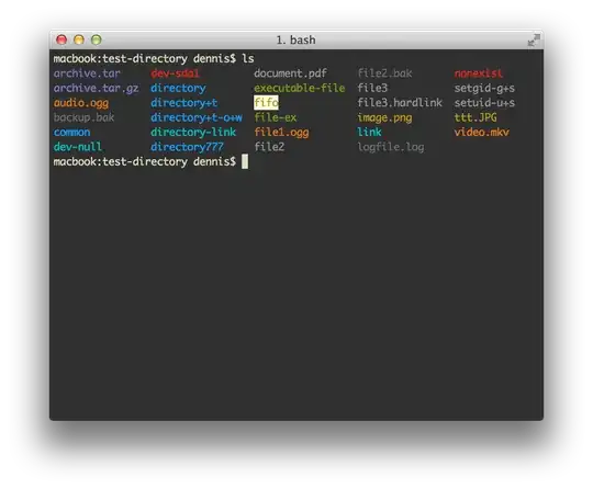

I would like to set the Max OS X Terminal theme for Ubuntu Terminal. I really like the fonts and the colors. This is how the Mac Terminal does look:
Image source
There are few things that I want to see in the Ubuntu Terminal:
  • I want to replace username@desktop:~/Dropbox$ with the username and the computer name in this format: desktop:Dropbox username$
  • I want to change the Terminal font to look like in the Mac terminal.
  • I want to change the color scheme to be like the Mac terminal color scheme.
Is this possible? How?
Note that I don't want to change the Ubuntu theme. I use Unity with default theme, but I want to change only the terminal settings because it's the most used application by me.

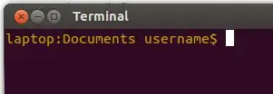

Changing the prompt style
To change the prompt format, add the following lines in ~/.bashrc file:
### Prompt style
export PS1="\033[0;33m\h:\W \u\$ \e[m"
Now the terminal looks like this:

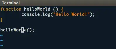

Terminal font
Intall Monaco font. You can run this in Terminal:
curl -kL https://raw.githubusercontent.com/cstrap/monaco-font/master/install-font-ubuntu.sh | bash
Warning: You may have issues with this font in browser. This is discussed here.
Then set the Terminal font to use Monacao: go to Edit -> Profile Preferences and change the font:

Then import the color scheme running the following command:
gconftool-2 --load terminal-color-scheme.xml
...where terminal-color-scheme.xml is the name of the XML file that contains the content above.
After that, your terminal will look like below:

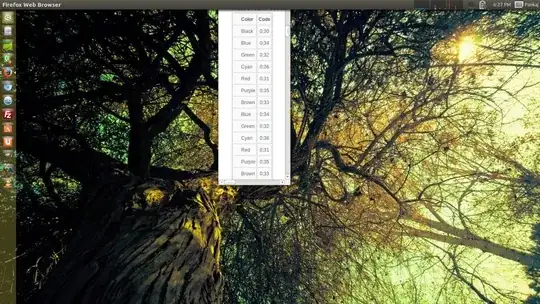

To set a green color prompt, type the following command:
$ export PS1="\e[0;32m[\u@\h \W]\$ \e[m "
Change the color code as per to your desire from the table shown below.
COLOUR CODES
