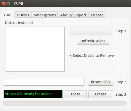

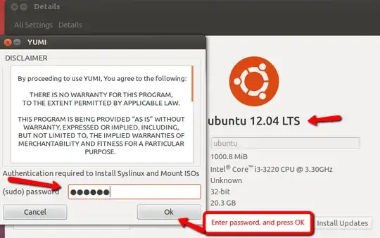

As far as installing Yumi, you have to install gambas3 prior to installing yumi to satisfy dependencies.
To install, download Yumi deb file. After the file is downloaded, just press Ctrl+Alt+T on your keyboard to open Terminal. When it opens, navigate to where the file was downloaded (Probably the Downloads Folder), and run the command(s) below:
sudo add-apt-repository ppa:nemh/gambas3
sudo apt-get update
sudo apt-get dist-upgrade
sudo apt-get install gambas3
sudo dpkg -i yumi_0.0.1-1_all.deb
That should install Yumi, See images below.
