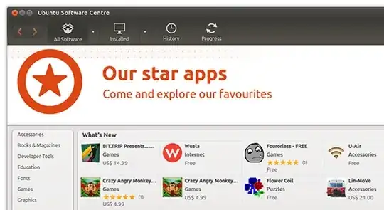

First of all synaptic is not installed by default in Ubuntu 12.04 unless you installed it manually. Most probably the problem is causing by software center. It may happen that when you are trying to update apt-cache, the software center is also trying the same. That is causing the error. To be sure you can open software center and on top right (last icon) you might get an busy or 'progress' icon.
Then wait for software center to finish its action. Then try apt-get update. I am not sure if software center center can work or not from virtual console. If Software center can work from VC the process might be over already that is why you did not get any error.
