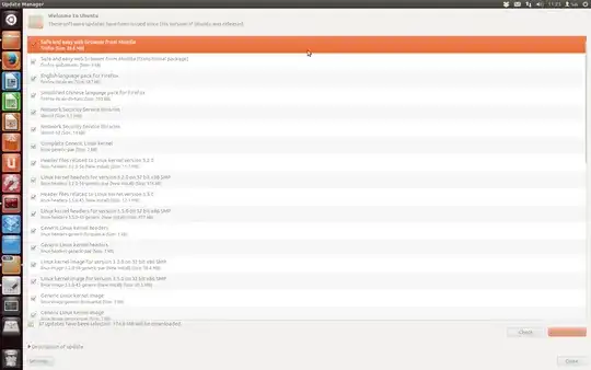

When the Install Updates button is pressed in the Update Manager, the Update Manager freezes.
Screenshot for explaining the issue
Update and upgrade did not solve the issue.
I am getting the following error message:

Try running the following commands as an alternative:
sudo apt-get update
sudo apt-get upgrade
That will run the updates for you, maybe after those are run your update manager will work.
Trevor Gross
  • 408
permissions in your python packages are possibly not working , change its permission by using-
sudo chown -R $USER /usr/local/lib/python2.7/dist-packages/
-Replace USER with your login name, if this doesnt works check the output of -
/usr/lib/ubuntu-sso-client/ubuntu-sso-login
If it throw any error ImportError: No module named pkg_resources
then the reason behind this could be setup tools package has been deleted in my Python environment .to solve this use the following script-
curl https://bitbucket.org/pypa/setuptools/raw/bootstrap/ez_setup.py | python
hope it will work.
