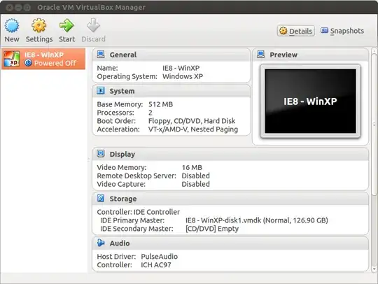

    At this point, my Virtual Machine was looking like it is installed but in Powered off mode.
    IE8 WinXP machine in power off state

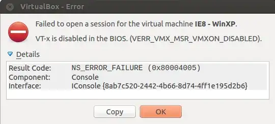

    When I tried to start it, it gave me the following error -
    VT-x error
    I resolved it by referring to answer of How do I enable hardware visualization technology (VT-x) for use in Virtualbox? i.e. by enabling visualization in BIOS Advance settings (To enter BIOS, I press F2 before Ubuntu's grub menu appears when computer is starting).

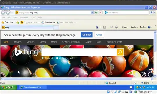

Once this last piece of error taken care of, my Oracle VM VirtualBox started showing IE8 on WinXP and also powered it on correctly.
