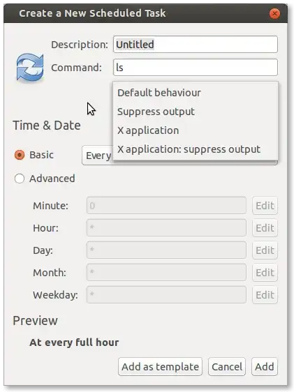

Scheduled tasks
Install via the software center
It is the Task Scheduler in Gnome.
In other way it is a GUI for Cron.
Can be installed with Software Center.
If use Terminal for installation:
sudo apt-get install gnome-schedule
