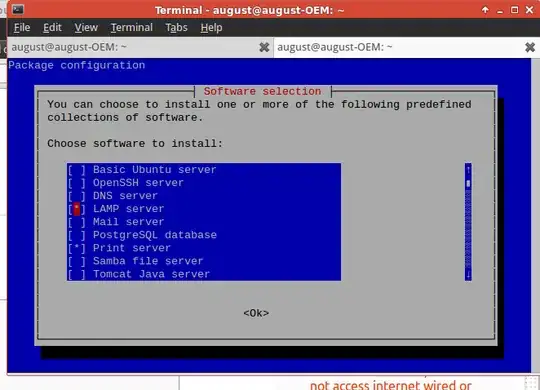

Open your terminal and install tasksel with
sudo apt-get install tasksel
and type as
sudo tasksel
There select Lamp server with space bar and then select ok as I have show in the image that will install lamp server in your Ubuntu automatically.
