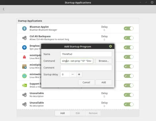

  5. IMPORTANT: When the speed is chosen, copy the command to autostart:
    Startup Applications
If the settings stop working at some point, check the ID or the device's properties again. There may be some changes to your devices table, and the ID may shift.
